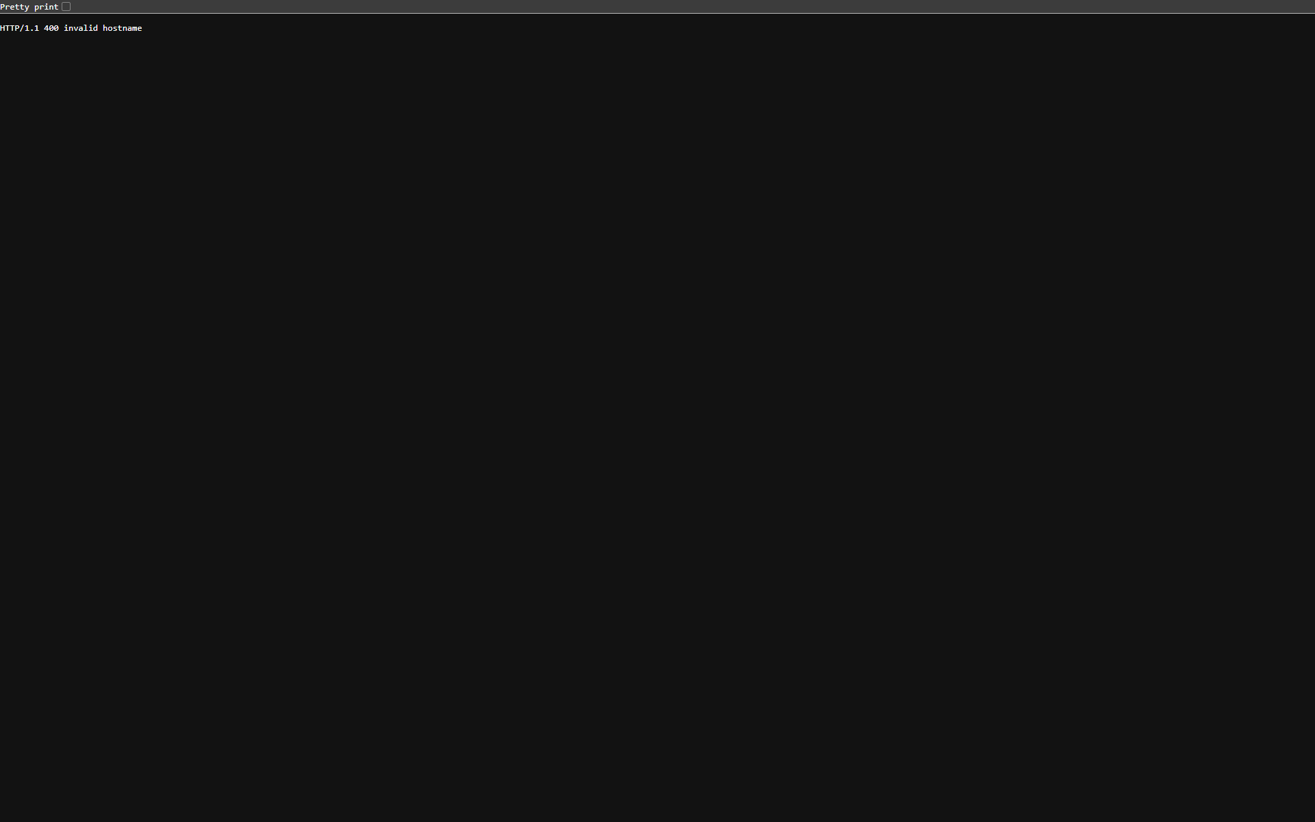

I get the following error when trying to access the Port 80 of the CP Plus IP Camera!
